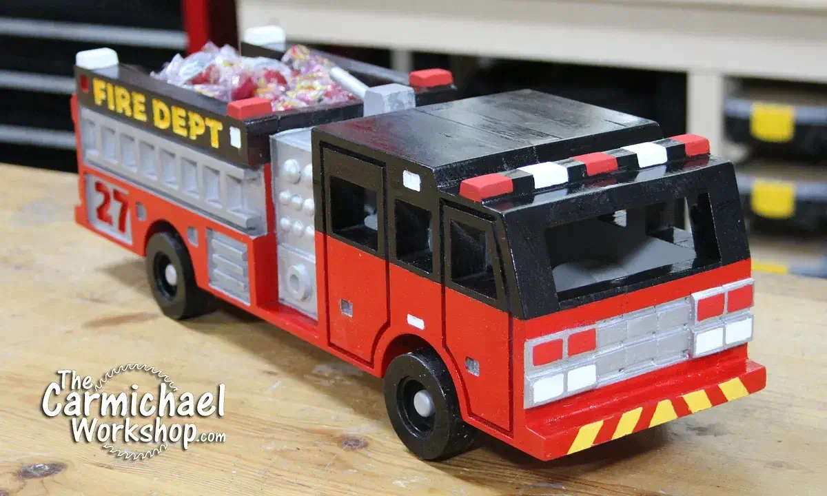

Keep glue away from surfaces that need to move
Steve Carmichael adds a washer between the fire engine and each wheel, and warns against gluing the wheel to its axle peg. Fred Housel uses a different arrangement: the dowel fits tightly in the wheels but turns in a slightly larger body hole. Choose which part will rotate before drilling and gluing, so the joint that needs to move stays free.
Project notes by Steve Carmichael: read the source.
From Fire Engine by Steve Carmichael.

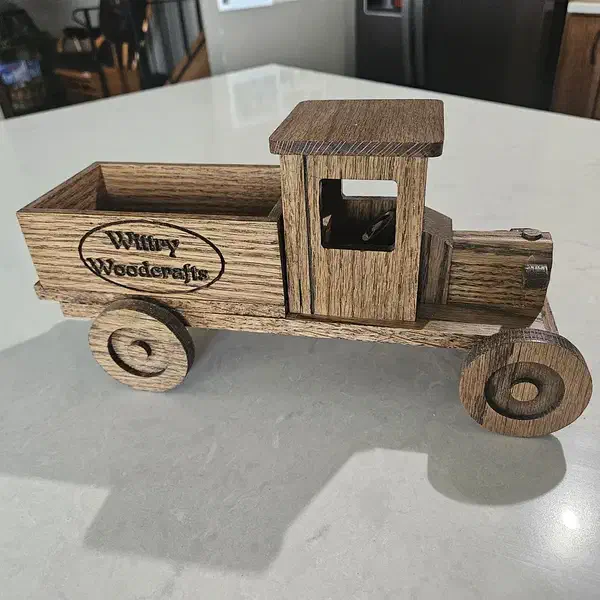

Paint inside the cab before closing it up
Carmichael paints the surfaces visible through the cab windows before gluing the layers together, leaving the glue faces bare. Wittry likewise recommends staining the truck’s parts before assembly. Reach enclosed surfaces while the parts are separate, and keep bonding faces free of finish.

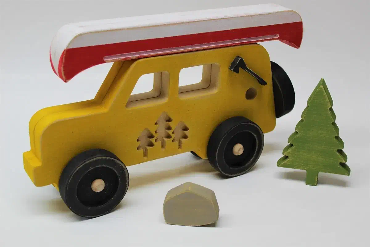

Give the campsite tree a base of its own
Sam Picken adapted Pietruszko’s camping set by carving a pocket in the rock that accepts the tree trunk. The tree then has a place to stand beside the car. If you add scenery, fit the trunk and pocket together as a pair rather than relying on the thin tree edge alone.
Comment by Sam Picken: read the source.
From Best Camping Trip Ever!!! by Peter Pietruszko.

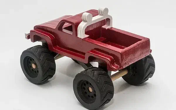

Draw the body around the wheels and axles
For a rolling car, pair the body holes with the axle and wheel arrangement. A layered pickup also needs cab, bed and middle sections; a rubber-band racer needs space for its moving mechanism.
