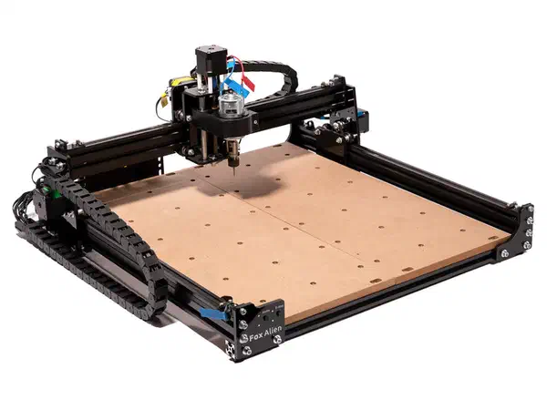

FoxAlien no longer sells this model, but owners can keep using it with Easel. The Masuter has a 400 x 380 x 55 mm working area, a 775-type spindle (10,000 RPM), and is compatible with GRBL software. It assembles in 20-30 minutes.
