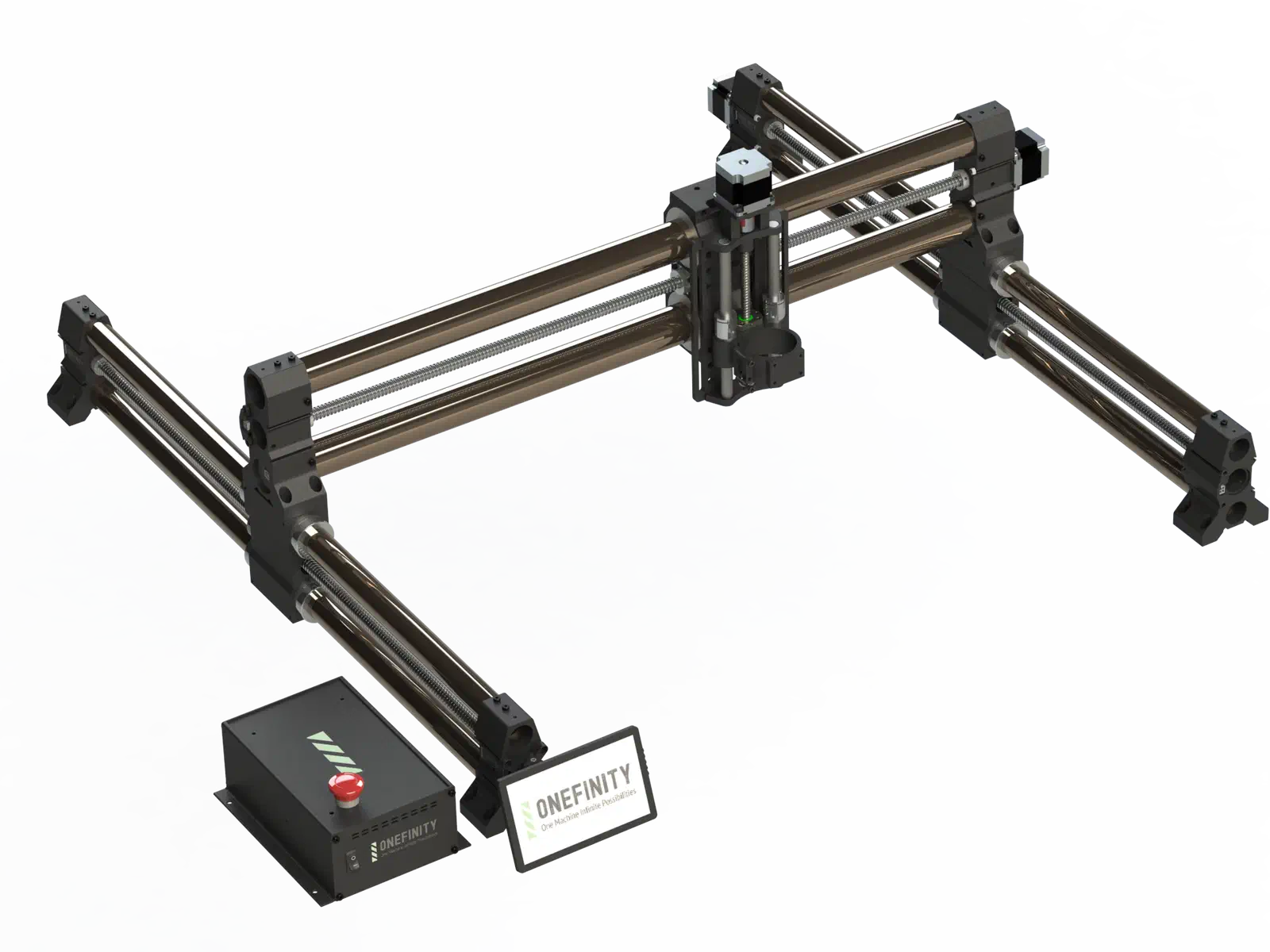

Onefinity Original Series X-50 machine photo
About the Machine
Onefinity no longer sells this model, but it remains fully supported in Easel. The Original Series X-50 was sold in two cut areas: Woodworker at 32 1/8in x 32 1/8in x 5 1/4in and Journeyman at 48 1/8in x 32 1/8in x 5 1/4in. Both ride on a 50mm hollow linear-motion shaft on X and two 35mm hollow shafts on Y, with sealed linear bearings, a 1616 ball screw, and a larger stepper motor rated up to 40% more torque than the X-35 generation; both used an optional BB Buildbotics controller with no router or spindle included.

Quick Specs
Cuttable Area
Woodworker: 32 1/8 x 32 1/8 x 5 1/4 in; Journeyman: 48 1/8 x 32 1/8 x 5 1/4 in
Spindle Power
Not included; designed for the Makita RT0701C 1-1/4 HP compact router
Stepper Motors
Larger stepper motor, up to 40% more torque than the X-35 generation (no exact NEMA size or torque figure stated)
Drive System
50mm hollow linear shaft on X, two 35mm hollow shafts on Y, sealed linear bearings, 1616 ball screw
Controller
Connectivity
USB
